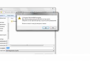

Проблем с акаунта на Windows 7
Проблемът е че, когато искам да иснталирам нещо или да изтегля нещо в дадена папка изкарва следната грешка:
3 дни си блъсках главата ето как става
You don't have to do this for every subfolders, just the main folder.
Rightclick the folder -> chose properties -> chose security tab
Click on advanced -> click the owner tab -> click on the edit button
Click on your username -> check the box: Owner of underlying containers and object.
click a few times ok until your are back in the explorer.
Now rightclick the folder again -> Chose security again -> click on edit
click on add.-> type your username in the white area, and click on check name.
click ok once. You are now in the security box again.
now select your user name and in the permission box select full control.
Click ok
Your done.
