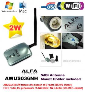

ALFA AWUS036NH 802.11n/b/g 2W Long-Range USB Adapter
Compatible with IEEE 802.11n, 802.11g and 802.11b standards
Support Frequency Band of 2.412GHz - 2.4835GHz ISM band
High Transmitter Power up to 2000mW max
Brand NEW
Retail Package includes ALFA AWUS036NH adapter, 5dBi antenna, USB cable, driver CD
Free Gift of Mount Holder
NOTE: NOT support 5GHz Frequency Band
Specifications :
Standards : IEEE 802.11 n/b/g
Interface: USB 2.0 mini USB
Data Rate:
802.11n: UP to 150Mbps
802.11g: UP to 54Mbps
802.11b: UP to 11Mbps
Frequency Band : 2.412GHz - 2.4835GHz ISM band
Transmitter Power: 2W Max.
Data Modulation Type: BPSK,QPSK, CCK and OFDM
Security: 64/128-bit WEP, WPA, WPA2, TKIP, AES
Supporting O.S.:
Windows 2000 / XP / Vista / Windows 7
Mac v10.4, 10.5, 10.6
Linux 2.6

само дето по закон нямаш право да го ползваш!
