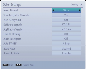

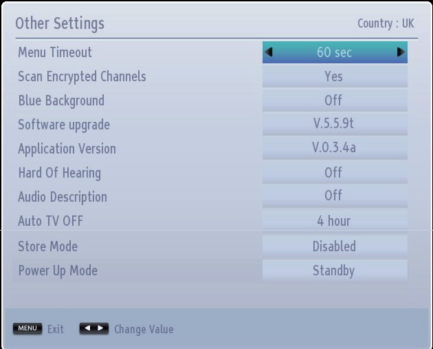

Store ModeIf you set Store Mode to Enabled, your TV’sfeatures will be illustrated on the top of the screen.To deactivate this feature, please set to Disabled.
post-7880-0-78037400-1384363266_thumb.pn
