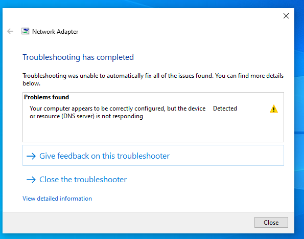

Като се появи този прозорец кликни на View detailed information и копирай съдържанието на прозореца, след което го постави тук в темата.

Вече ми излезе troubleshooting couldn't identify the problem

преди 2 минути, цър-вул написа:
Изключи си за 2 минути рутъра и го включи.
Network Adapter
Publisher details
Issues found
Your computer appears to be correctly configured, but the device or resource (DNS server) is not responding
Detected
Contact your network administrator or Internet service provider (ISP)
Not run
The default gateway is not available
The default gateway is a device that connects a local network or computer to the Internet. A broadband modem or router is usually the default gateway.
Fixed
Reset the "Wi-Fi" adapter
Completed
Investigate router or broadband modem issues
Not run
Issues found
Detection details
6
Detected
Not run
Windows can't communicate with the device or resource (DNS server). The computer or service you are trying to reach might be temporarily unavailable. If the device or resource is nearby and you have access to it, make sure it is turned on and connected to the network.
6
Fixed
Completed
This can sometimes resolve an intermittent problem.
Network Diagnostics Log
File Name:797476AD-93CA-480C-B64A-AA31DCC48D50.Repair.1.etl
Not run
If you're connected to a hotspot or domain network, contact the network administrator. Otherwise: 1. Unplug or turn off the device. 2. After all the lights on the device are off, wait at least 10 seconds. 3. Turn the device on or plug it back into the power outlet. To restart a router or modem that has a built-in battery, press and quickly release the Reset button.
Detection details
Diagnostics Information (Network Adapter)
Details about network adapter diagnosis: Network adapter Wi-Fi driver information: Description . . . . . . . . . . : Qualcomm Atheros AR5B125 Wireless Network Adapter Manufacturer . . . . . . . . . : Qualcomm Atheros Communications Inc. Provider . . . . . . . . . . . : Qualcomm Atheros Communications Inc. Version . . . . . . . . . . . : 10.0.3.456 Inf File Name . . . . . . . . . : C:\WINDOWS\INF\oem21.inf Inf File Date . . . . . . . . . : Friday, March 26, 2021 7:32:28 PM Section Name . . . . . . . . . : ATHR_DEV_OS61_661711AD.ndi Hardware ID . . . . . . . . . . : pci\ven_168c&dev_0032&subsys_661711ad Instance Status Flags . . . . . : 0x180200a Device Manager Status Code . . : 0 IfType . . . . . . . . . . . . : 71 Physical Media Type . . . . . . : 9
Diagnostics Information (Wireless Connectivity)
Details about wireless connectivity diagnosis: Information for connection being diagnosed Interface GUID: a4430251-a731-4b41-a711-ad48071b323e Interface name: Qualcomm Atheros AR5B125 Wireless Network Adapter Interface type: Native Wi-Fi Connection incident diagnosed Auto Configuration ID: 1 Connection ID: 1 Connection status summary Connection started at: 2021-04-16 11:17:39-252 Profile match: Success Pre-Association: Success Association: Success Security and Authentication: Success List of visible access point(s): 5 item(s) total, 5 item(s) displayed BSSID BSS Type PHY Signal(dB) Chnl/freq SSID ------------------------------------------------------------------------- F4-F2-6D-32-75-DC Infra <unknown> -68 6 Albena C4-A3-66-5D-23-54 Infra <unknown> -55 5 Cvetkova 78-54-2E-57-F6-14 Infra <unknown> -64 11 Mladen 9C-9D-7E-2F-93-50 Infra <unknown> -42 9 (Unnamed Network) 50-A9-DE-79-02-88 Infra <unknown> -64 9 BlackSea Connection History Information for Auto Configuration ID 1 List of visible networks: 9 item(s) total, 9 item(s) displayed BSS Type PHY Security Signal(RSSI) Compatible SSID ------------------------------------------------------------------------------ Infra <unknown> Yes 42 Yes VIVACOM Infra <unknown> Yes 14 Yes Koko Infra <unknown> Yes 34 Yes Albena Infra <unknown> Yes 56 Yes Cvetkova Infra <unknown> Yes 46 Yes Mladen Infra <unknown> Yes 4 Yes (Unnamed Network) Infra <unknown> Yes 16 Yes Plamcho Infra <unknown> Yes 10 Yes PEI4EVA Infra <unknown> Yes 48 Yes BlackSea List of preferred networks: 3 item(s) Profile: Cvetkova SSID: Cvetkova SSID length: 9 Connection mode: Infra Security: Yes Set by group policy: No Connect even if network is not broadcasting: No Connectable: Yes Profile: Galaxy A30s9101 SSID: Galaxy A30s9101 SSID length: 15 Connection mode: Infra Security: Yes Set by group policy: No Connect even if network is not broadcasting: No Connectable: No Reason: 0x00028003 Profile: GeshaMegi SSID: GeshaMegi SSID length: 9 Connection mode: Infra Security: Yes Set by group policy: No Connect even if network is not broadcasting: No Connectable: No Reason: 0x00028003 Information for Connection ID 1 Connection started at: 2021-04-16 11:17:39-252 Auto Configuration ID: 1 Profile: Cvetkova SSID: Cvetkova SSID length: 9 Connection mode: Infra Security: Yes Pre-Association and Association Connectivity settings provided by hardware manufacturer (IHV): No Security settings provided by hardware manufacturer (IHV): No Profile matches network requirements: Success Pre-association status: Success Association status: Success Last AP: c4-a3-66-5d-23-54 Security and Authentication Configured security type: WPA2-PSK Configured encryption type: CCMP(AES) 802.1X protocol: No Key exchange initiated: Yes Unicast key received: Yes Multicast key received: Yes Number of security packets received: 0 Number of security packets sent: 0 Security attempt status: Success Connectivity Packet statistics Ndis Rx: 103103 Ndis Tx: 48210 Unicast decrypt success: 3296 Multicast decrypt success: 0 Unicast decrypt failure: 0 Multicast decrypt failure: 0 Rx success: 3325 Rx failure: 3493 Tx success: 1113 Tx failure: 0 Tx retry: 74 Tx multiple retry: 12 Tx max lifetime exceeded: 0 Tx ACK failure: 13021 Roaming history: 0 item(s)
Details about wireless connectivity diagnosis: For complete information about this session see the wireless connectivity information event. Helper Class: Auto Configuration Initialize status: Success Information for connection being diagnosed Interface GUID: a4430251-a731-4b41-a711-ad48071b323e Interface name: Qualcomm Atheros AR5B125 Wireless Network Adapter Interface type: Native Wi-Fi Result of diagnosis: There may be problem
Diagnostics Information (Wireless Network Adapter)
Details about wireless network adapter diagnosis: For complete information about this session see the wireless connectivity information event. Helper Class: Native Wi-Fi MSM Initialize status: Success Information for connection being diagnosed Interface GUID: a4430251-a731-4b41-a711-ad48071b323e Interface name: Qualcomm Atheros AR5B125 Wireless Network Adapter Interface type: Native Wi-Fi Profile: Cvetkova SSID: Cvetkova SSID length: 9 Connection mode: Infra Security: Yes Connect even if network is not broadcasting: No Result of diagnosis: There may be problem

Обади се на интернет доставчика си да провери първо да не би при него да има проблем като за начало. После ще видим.
'Ора вие прочетохте ли грешката уе?
преди 2 часа, Теодор Тодоров написа:
DNS нещо не са наред, значи звъниш на доставчика да си ги оправи или ак имаш достъп до настройките на рутера трябва да го смениш с някой друг, например :
8.8.8.8
8.8.4.4
77.88.8.8
77.88.8.1
преди 6 минути, Bubbles написа:
8.8.8.8
8.8.4.4
77.88.8.8
77.88.8.1
Поправих го със тея команди:
ipconfig/flushdns
ipconfig /registerdns
ipconfig /release
ipconfig /renew
и рестарт на компа
