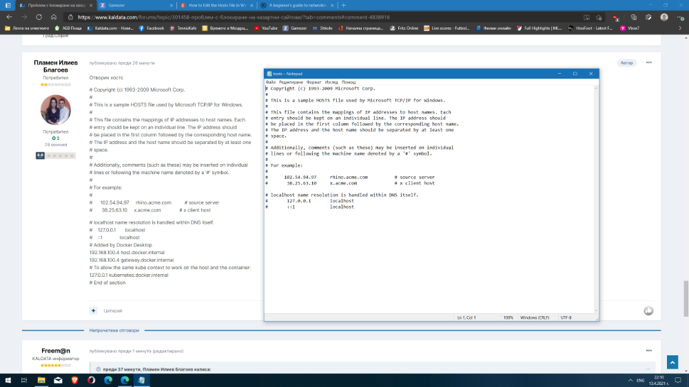

Провери дали е забранен в hosts.
Стартирай notepad като администратор и отвори там hosts.
https://imgur.com/yavZs6x

Отворих хостс
# Copyright (c) 1993-2009 Microsoft Corp.
# This is a sample HOSTS file used by Microsoft TCP/IP for Windows.
# This file contains the mappings of IP addresses to host names. Each
# entry should be kept on an individual line. The IP address should
# be placed in the first column followed by the corresponding host name.
# The IP address and the host name should be separated by at least one
# space.
# Additionally, comments (such as these) may be inserted on individual
# lines or following the machine name denoted by a '#' symbol.
# For example:
#      102.54.94.97     rhino.acme.com          # source server
#       38.25.63.10     x.acme.com              # x client host
# localhost name resolution is handled within DNS itself.
#    127.0.0.1       localhost
#    ::1             localhost
# Added by Docker Desktop
192.168.100.4 host.docker.internal
192.168.100.4 gateway.docker.internal
# To allow the same kube context to work on the host and the container:
127.0.0.1 kubernetes.docker.internal
# End of section

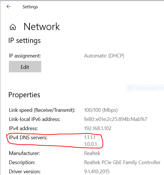

Тогава остава (според мен) betblocker или да забранява чрез защитната стена или чрез DNS сървърите (да изпраща в някой свой и от там вече да разпределя).
Така че виж за всеки случай какво има тук:
А за защитната стена не зная дали ще може да се помогне от разстояние.
