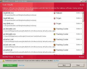

Здравейте,
МБАМ не откри нищо.
Ето ги и логовете:
HitmanPro 3.7.9.212www.hitmanpro.com   Computer name . . . . : KIM-PC   Windows . . . . . . . : 6.1.1.7601.X64/4   User name . . . . . . : KIM-PCKIM   UAC . . . . . . . . . : Disabled   License . . . . . . . : Trial (Expired)   Scan date . . . . . . : 2014-03-03 11:09:42   Scan mode . . . . . . : Normal   Scan duration . . . . : 8m 25s   Disk access mode  . . : Direct disk access (SRB)   Cloud . . . . . . . . : Internet   Reboot  . . . . . . . : No   Threats . . . . . . . : 3   Traces  . . . . . . . : 40   Objects scanned . . . : 1,925,865   Files scanned . . . . : 36,823   Remnants scanned  . . : 372,923 files / 1,516,119 keysMalware _____________________________________________________________________   C:ProgramDataMicrosoftBingDesktopBingCoretemptmp1BAB.exe	  Size . . . . . . . : 112,682 bytes	  Age  . . . . . . . : 21.7 days (2014-02-09 18:11:05)	  Entropy  . . . . . : 7.7	  SHA-256  . . . . . : DAEE20622AA40A51E1AAF58B84B5F8FFD43728A12E4EF7B4C764BAA0C18D4743    > Bitdefender  . . . : Dropped:Trojan.GenericKD.1566115    > Kaspersky  . . . . : Trojan.Win32.Miuref.b	  Fuzzy  . . . . . . : 106.0	  Forensic Cluster		 -0.6s C:ProgramDataMicrosoftBingDesktopBingCoretemptmp1BAB.tmp		  0.0s C:ProgramDataMicrosoftBingDesktopBingCoretemptmp1BAB.exe   C:ProgramDataMicrosoftBingDesktopBingCoretemptmpB00E.exe	  Size . . . . . . . : 390,887 bytes	  Age  . . . . . . . : 11.6 days (2014-02-19 21:51:01)	  Entropy  . . . . . : 7.8	  SHA-256  . . . . . : DC7603A2C9ADEDC5A4F959EA9FD846049068B40FF9CAD8C95BF04155CA66CB8C    > Bitdefender  . . . : Gen:Variant.Kazy.339345    > Kaspersky  . . . . : not-a-virus:RiskTool.Win32.BitCoinMiner.mye	  Fuzzy  . . . . . . : 107.0	  Forensic Cluster		 -1.5s C:ProgramDataMicrosoftBingDesktopBingCoretemptmpB00E.tmp		  0.0s C:ProgramDataMicrosoftBingDesktopBingCoretemptmpB00E.exe		  1.3s C:FRSTQuarantinewincrt02-03-2014_17-14-26		  1.3s C:FRSTQuarantinewincrt02-03-2014_17-14-26m_bin		  3.6s C:FRSTQuarantinewincrt02-03-2014_17-14-26m_binpthreadGC2.dll		  3.7s C:FRSTQuarantinewincrt02-03-2014_17-14-26m_binzlib1.dll   C:ProgramDataMicrosoftBingDesktopBingCoretemptmpE36E.exe	  Size . . . . . . . : 102,243 bytes	  Age  . . . . . . . : 48.5 days (2014-01-13 22:07:28)	  Entropy  . . . . . : 7.7	  SHA-256  . . . . . : 50C0139420CBEE66B374CF5995B3EA2692CC25067EEB0343D0FCD20F945D49C1    > Bitdefender  . . . : Gen:Variant.Symmi.37806    > Kaspersky  . . . . : Trojan.Win32.Inject.hfpx	  Fuzzy  . . . . . . : 106.0Cookies _____________________________________________________________________   C:UsersKIMAppDataLocalGoogleChromeUser DataDefaultCookies:ad.360yield.com   C:UsersKIMAppDataLocalGoogleChromeUser DataDefaultCookies:doubleclick.net   C:UsersKIMAppDataLocalGoogleChromeUser DataDefaultCookies:revsci.net   C:UsersKIMAppDataLocalGoogleChromeUser DataDefaultCookies:track.adform.net   C:UsersKIMAppDataRoamingMicrosoftWindowsCookiesJ5XWQ90A.txt   C:UsersKIMAppDataRoamingMicrosoftWindowsCookiesQX7U6ZD5.txt   C:UsersKIMAppDataRoamingMicrosoftWindowsCookiesZG3UY0L6.txt   C:UsersKIMAppDataRoamingMozillaFirefoxProfilesos9u0rq6.defaultcookies.sqlite:ad.360yield.com   C:UsersKIMAppDataRoamingMozillaFirefoxProfilesos9u0rq6.defaultcookies.sqlite:ad.ad-srv.net   C:UsersKIMAppDataRoamingMozillaFirefoxProfilesos9u0rq6.defaultcookies.sqlite:ad.adc-serv.net   C:UsersKIMAppDataRoamingMozillaFirefoxProfilesos9u0rq6.defaultcookies.sqlite:ad.adnet.de   C:UsersKIMAppDataRoamingMozillaFirefoxProfilesos9u0rq6.defaultcookies.sqlite:ads.kaldata.com   C:UsersKIMAppDataRoamingMozillaFirefoxProfilesos9u0rq6.defaultcookies.sqlite:ads.p161.net   C:UsersKIMAppDataRoamingMozillaFirefoxProfilesos9u0rq6.defaultcookies.sqlite:ads.pubmatic.com   C:UsersKIMAppDataRoamingMozillaFirefoxProfilesos9u0rq6.defaultcookies.sqlite:ads.yahoo.com   C:UsersKIMAppDataRoamingMozillaFirefoxProfilesos9u0rq6.defaultcookies.sqlite:adserver.abv.bg   C:UsersKIMAppDataRoamingMozillaFirefoxProfilesos9u0rq6.defaultcookies.sqlite:adtech.de   C:UsersKIMAppDataRoamingMozillaFirefoxProfilesos9u0rq6.defaultcookies.sqlite:advertising.com   C:UsersKIMAppDataRoamingMozillaFirefoxProfilesos9u0rq6.defaultcookies.sqlite:atdmt.com   C:UsersKIMAppDataRoamingMozillaFirefoxProfilesos9u0rq6.defaultcookies.sqlite:doubleclick.net   C:UsersKIMAppDataRoamingMozillaFirefoxProfilesos9u0rq6.defaultcookies.sqlite:eas.apm.emediate.eu   C:UsersKIMAppDataRoamingMozillaFirefoxProfilesos9u0rq6.defaultcookies.sqlite:eas21.emediate.eu   C:UsersKIMAppDataRoamingMozillaFirefoxProfilesos9u0rq6.defaultcookies.sqlite:fastclick.net   C:UsersKIMAppDataRoamingMozillaFirefoxProfilesos9u0rq6.defaultcookies.sqlite:homesexland.com   C:UsersKIMAppDataRoamingMozillaFirefoxProfilesos9u0rq6.defaultcookies.sqlite:invitemedia.com   C:UsersKIMAppDataRoamingMozillaFirefoxProfilesos9u0rq6.defaultcookies.sqlite:largeporntube.com   C:UsersKIMAppDataRoamingMozillaFirefoxProfilesos9u0rq6.defaultcookies.sqlite:media6degrees.com   C:UsersKIMAppDataRoamingMozillaFirefoxProfilesos9u0rq6.defaultcookies.sqlite:mediaplex.com   C:UsersKIMAppDataRoamingMozillaFirefoxProfilesos9u0rq6.defaultcookies.sqlite:pcworldcommunication.122.2o7.net   C:UsersKIMAppDataRoamingMozillaFirefoxProfilesos9u0rq6.defaultcookies.sqlite:pool-eu-ie.creative-serving.com   C:UsersKIMAppDataRoamingMozillaFirefoxProfilesos9u0rq6.defaultcookies.sqlite:ru4.com   C:UsersKIMAppDataRoamingMozillaFirefoxProfilesos9u0rq6.defaultcookies.sqlite:serving-sys.com   C:UsersKIMAppDataRoamingMozillaFirefoxProfilesos9u0rq6.defaultcookies.sqlite:smartadserver.com   C:UsersKIMAppDataRoamingMozillaFirefoxProfilesos9u0rq6.defaultcookies.sqlite:track.adform.net   C:UsersKIMAppDataRoamingMozillaFirefoxProfilesos9u0rq6.defaultcookies.sqlite:tradedoubler.com   C:UsersKIMAppDataRoamingMozillaFirefoxProfilesos9u0rq6.defaultcookies.sqlite:www.googleadservices.com   C:UsersKIMAppDataRoamingMozillaFirefoxProfilesos9u0rq6.defaultcookies.sqlite:yadro.ru

Това е защото премахнахме бацилите и вече Norton е прогледнал. Направете финална проверка с Hitmanpro и публикувайте резултатите.
