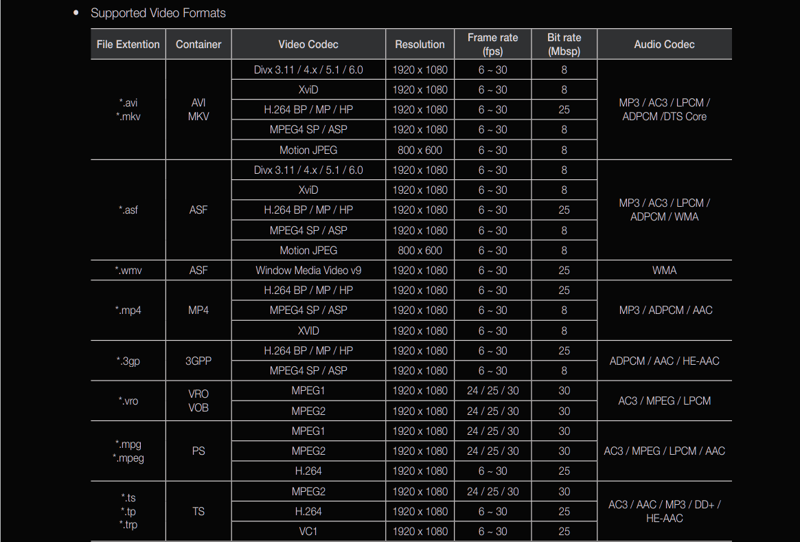

Need-to-Know List before using Media Play
x MTP (Media Transfer Protocol) is not supported.
x The file system supports FAT16, FAT32 and NTFS.
x Certain types of USB Digital camera and audio devices may not be compatible with this TV.
x Media Play only supports USB Mass Storage Class (MSC) devices. MSC is a Mass Storage Class Bulk-Only Transport device. Examples of MSC are Thumb drives, Flash Card Readers and USB HDD (USB HUB are not supported). Devices should be connected directly to the TV’s USB port.
https://downloadcenter.samsung.com/content/UM/201003/20100317143701671/BN68-02558C-00L05_0223.pdf
