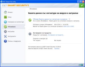

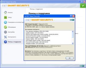

Работи си без проблеми новата версийка :)post-309632-0-10579100-1318090794_thumb. post-309632-0-27363800-1318091348_thumb.
