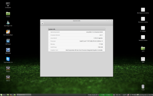

 Обнових до  Linux Mint 17.2 Rafaela  заради проблем с Nvidia driver крашва, когато има включен втори монитор с VGA кабел
Better support for UEFI, NVIDIA and Optimus cards
Grub was updated for Linux Mint 17.2 and brings better UEFI support and better compatibility with modern computers (this is known to fix live boot and graphical issues on many computers).
The NVIDIA drivers were upgraded from version 331.113 to version 346.72 to support recent NVIDIA chipsets.
MDM was given better support for NVIDIA Prime. On NVIDIA Optimus equipped computers, you can now switch between your Intel and your NVIDIA card with a simple log out. You no longer need to reboot.
A system tray icon also indicates which GPU is active and you can click on it to switch to the other one:
С радост установих, че проблема е оправен в тази версия
За сега ми харесва как се държи!
